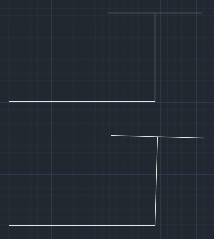

If I may ask, could someone please explain to me how to drill the bowl so it is canted?
I'm still confused on how it's done.
Re: Billiard Attempt Based On Information Provided From My Last Attempt And The Comments Shared
Are you drilling the bowl first or the shank first?
shikano53 wrote: Sat Feb 27, 2021 12:09 pm If I may ask, could someone please explain to me how to drill the bowl so it is canted?
It's really easy. When drawing the lines on the side of your block, draw the center axis of the tobacco chamber canted forward by about 1.5 degrees (or 1 degree, or whatever looks about right).
Here the bottom example is canted forward by 1.5 degrees for ease of illustration. The top is a perfect 90 degree intersection.
(16.48 KiB) Not downloaded yet
When drilling, I tend to drill the airway and mortis first, then rotate the block to drill the tobacco chamber. In my setup, it's as easy as following the lines - line up your drill bit axis with the line you drew, and go to town.
The ACTUAL SPECIFIC answer to your question varies with regard to your drilling setup and what tools you use, but that's basically it.
