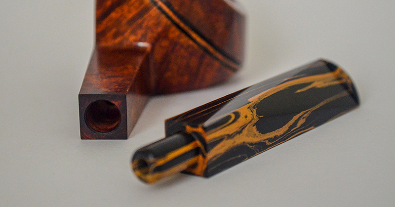

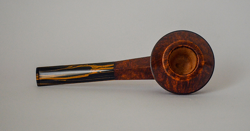

This is my second attempt making Dunhill inspiration Bulldog,
First was based on shape 145, and fo this one based on ODA 838 with some changes!
I've decided to make the shank narrower than 838. So, I create a negative elbow at the stem/shank junction! And I would like to know what do you think about it?
And also by doing so, the mortise wall also is thinner than 838 (~2mm min.), Is it too thin?!

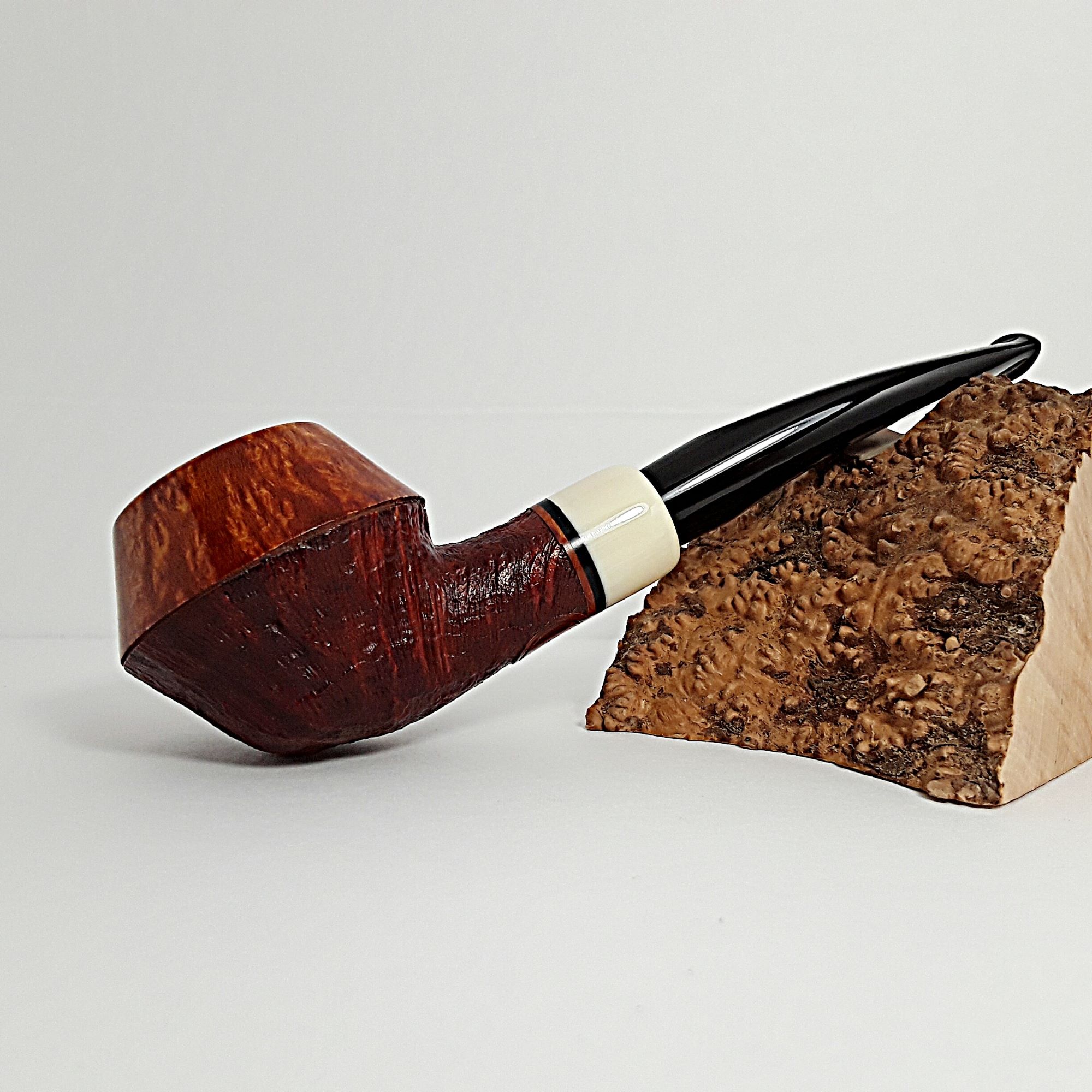

Well here is my submission. I hope it provides many years on great smokes and enjoyment to whomever recieves it. I chose the Rhodisian because I prefer the look and flow of the design. The pipe features a German Ebonite stem (cut tenon) with Faux Ivory and Ebonite recessed cap. Two tone blasted and smooth finish on the briar.
(462.51 KiB) Downloaded 1 time
