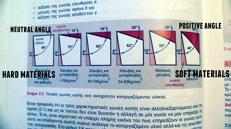

Hi Guys and thank you for your interest and the invitation.
Please excuse my English
Just the basics -
Basic cutting principle -
A knife-shaped tool, harder than the material that has to be cut moves to the opposite direction of the cutting material.
Basic cutting tool geometry and materials -
Neutral and Negative cutting angles:
For hard materials we need stiffer tools to obtain the cutting forces and maintain tool’s shape intact for a long period of time. The disadvantage is that we need more horsepower to take the cut and a really rigid set-up to hold the part. This is definitely not the case here.
Positive cutting angles:
With softer materials we can start to take advantage of narrow cutting tools that demands less horsepower, less rigid set-up and produce better surface finish. That sounds good to me.
Cutting edge -
Sharp edges can remove material easier, but they don’t last for long. A very sharp edge it will break easily. Actually, this is your only weapon against the bad choice of the cutting angle tool. That’s why you have an obsession with diamond files. You desperately try to make your tool sharper. If you sharpen only the edges, eventually you will turn your tool at a negative cutting angle tool that makes things even whores, so you have to sharpen the entire surface of the tool.
At the other hand, even a tiny radius on the edge can increase significantly tool’s life and it’s definitely better than a broken edge. A good choice on tool’s geometry allows a small radius on the edge. You don’t need diamond files.
Small or big pilot holes? -
It’s your choice… Test both is my opinion.
You can also try a deep small pilot hole and a big but narrow hole at the top of it. The tip of the tool will meet a smaller pilot hole at first and as it goes deeper the sides of the tool will touch the sides of the bigger hole and will self-align itself. We often use that technique at hand taping.
Choose what fit’s you.
Path corrections -
We all make mistakes, especially newbies. There is room for corrections if you apply enough force on the tool.
It’s easy to lose course or the tool cuts wildly -
That’s why I didn’t change the neutral cutting angles to the sides of the tool, to prevent this from happening. If you start straight you will need force to change your path and ruin your work.
I came to this design by trying to solve my customer’s problems and based on their feedback I have succeeded. This tool should be a better tool, at least in some degree. Otherwise I can’t explain the smile on my customer’s faces.
Although if you test my tools and you believe that we have to make any changes or we can improve thinks in any way I’m all ears.
You can also choose a standard spoon bit if you wish, without the hollow tip or even send me your own drawings. Just add a note to your order with your preference.
Thank you once again and let me know if you have any other questions.
