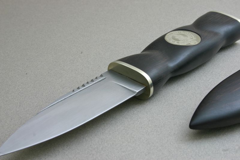

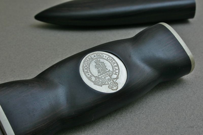

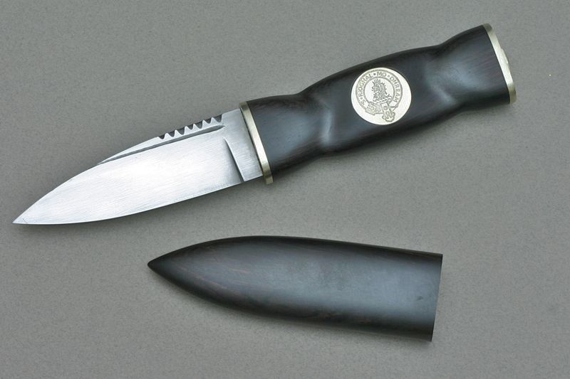

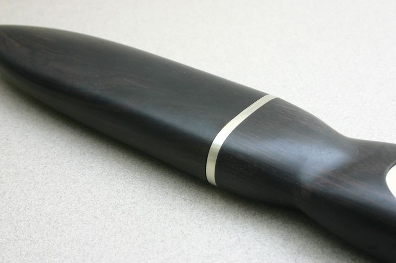

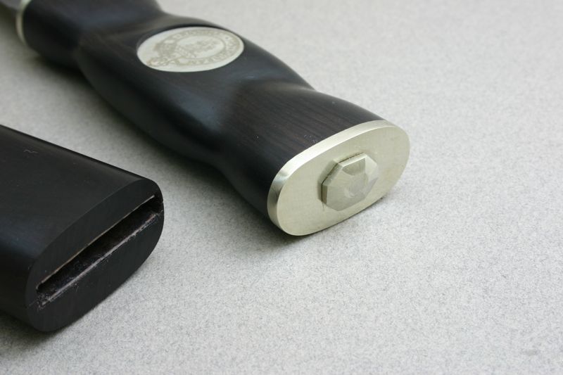

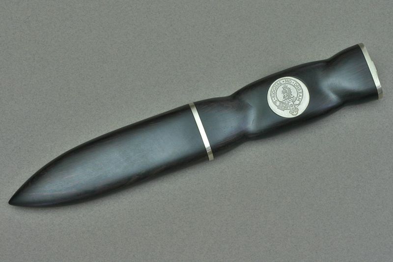

Still needs a coat of Danish oil, but this one is finished and will be heading to Scotland. The handle and sheath/scabbard are African Blackwood, same stuff Highland Pipes are made of, and the fittings are all nickel silver.

Steel type? OAL?

Steel is 1095, differentially heat treated, but the hamon is not polished out. It will show over the years though. It's also a hair under 9" OAL. The gent it's going to is about 7 feet tall, and wanted something that was handmade, devoid of plastic (as is customary these days :shock: ), suitable for black tie affairs of full highland dress, and fit his rather large self. The blade is a hair over 4", making it slightly larger than most Sgian Dubhs sold these days. Frankly, I can't imagine one any smaller - this fits my ham-fists perfectly.

When worn as part of highland attire, a sgian dubh is tucked into the sock (which are knee-high and secured with garters then folder over), with just the pommel showing. The whole ensemble can either be a daily wear affair, or the equiv of a full tuxedo.
