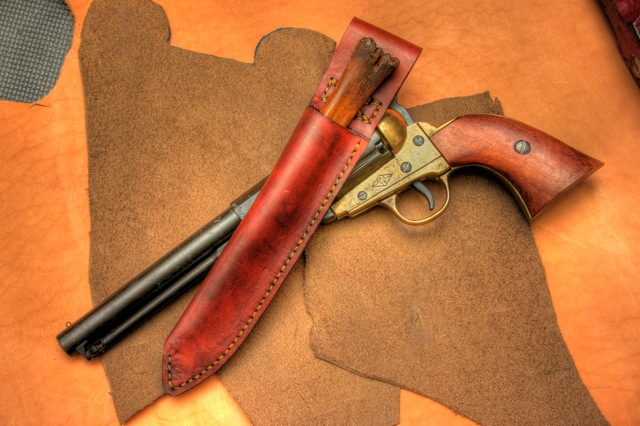

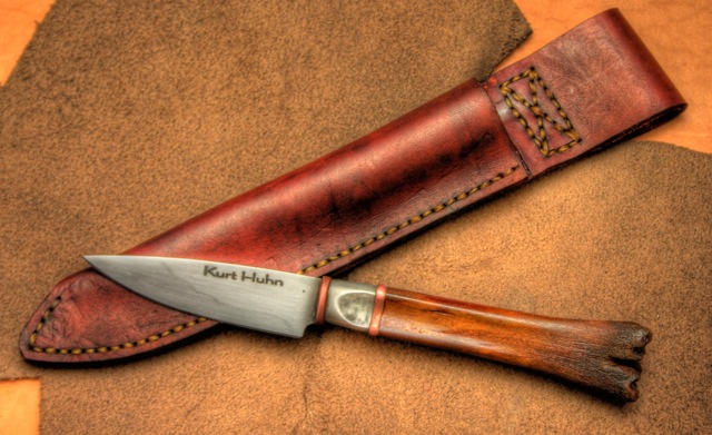

I put this gnarly thing together for a trade with a group of other makers - a KITH, actually. The theme was "throw me a bone".

Nice primitive, man. What is the guard bolster made from? Is your name laser etched on there?

Sweet work, Kurt. It all fits together thematically really nicely. Even the sheath fits the overall aesthetic.

Great knife Kurt! Is that a real bone or just carved to look like one? The big question I have though is, how do you get the stitches on your sheath so nice and even?

Frank wrote:Nice primitive, man. What is the guard bolster made from? Is your name laser etched on there?
It's actually electro-etched. I built my etcher using schematics (and then correcting the mistakes in them) from K-Net's documents library. After building it and throwing a meter on it, I found the polarity was reversed in the schematics.

Yes, the bone is stained. When they come to me they're anywhere from cream colored to stark white. This one has several coats of Fiebings medium brown rubbed into it with a rag.
I've not made a knife specifically for pipe making, no. I don't actually use a knife when making pipes, interestingly enough. I know some folks use one to scrape the stem prior to sanding, but I learned to make stems without that process.

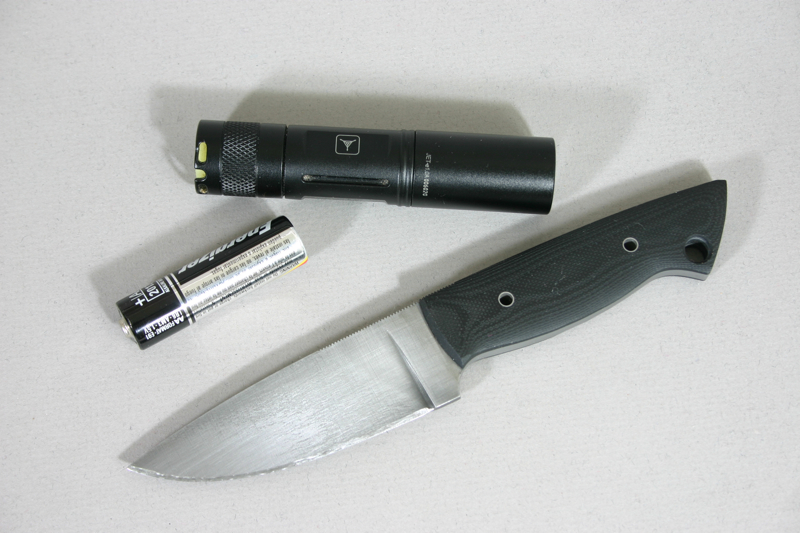

But small, quick knives - yes. There's this one that is used in my kitchen almost daily for boning chickens and other small animals:
Anvil wrote:Is that a real bone or just carved to look like one? The big question I have though is, how do you get the stitches on your sheath so nice and even?
That's deer leg bone. It might just be an ideal knife handle material. It's shape is perfect, it takes stain very well, it's hard as...bone, and it's conveniently hollow for inserting the tang of the blade.
Speaking of blade, I forgot to give details. The blade is 1095, edge quenched to give the spine some toughness. The bolster is cast pewter, and the other fittings are copper.
In order to keep the stitching straight and even, I used a stitching wheel. :) I got mine at a fabric store I think. After the sheath is glued up and the edge sanded to shape, I mark the stitch line and drill the holes with an awl held in the drill press. Since my stitching wheel was designed for fabric, I only drill every other or every third dimple. After that it's just a matter of threading through the holes.

Oh man. Stay away from those things. They're ungodly expensive, and making one only takes an afternoon - if that. You don't even need the crazy transformer that the Internet schematics call for. Mine has a 25V 450mA transformer, and works like a charm. Every part I needed, I picked up in one trip to the local Radio Shack (after calling to confirm they had the transformer in stock first) including the project box it's all housed in.
That knife in the OP was etched with 3 DC etchings of a 10-count each (probably 7 seconds), then switched to AC to deposit oxides for a 5-count. Technically speaking, a single DC 10-count might have been sufficient along with a 5-count AC - but I wanted the etch very deep on this one.
The stencils are a collection of trial and error, as well as lots and lots of research. I make my stencils using silkscreen resist from Circuit Bridge, and the sun as my exposure unit. I just print the design onto a transparency, create a sandwich with piece of G10, the silkscreen resist, the design/transparency, and a piece of borosilicate glass. I expose it to direct sunlight for 30-45 seconds, and develop the film, periodically rubbing it with a soft sponge to help get the unexposed gel off the screen. It sure beats paying through the nose to have someone else do it....
